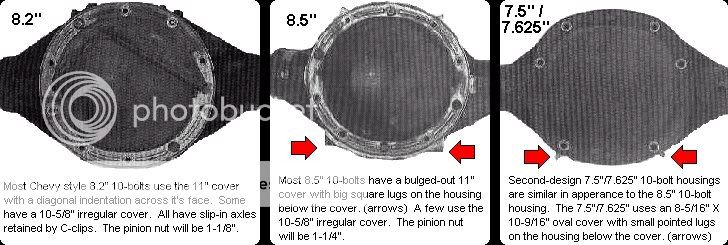

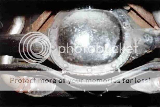

The GM Corporation 10 bolt 8.5 inch with square bottom.,. This is the preferred rear end.
10Bolt85inch
10Boltrearends
The 7.5 inch with "claws" and less preferred.
10Bolt75inch
(Edited, pic added}

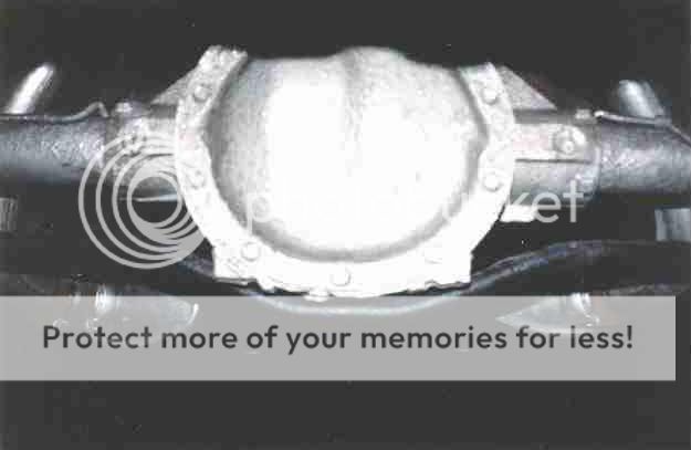

Does it look like this?
1082
Jim,
bs.phillips bs.phillips
New User | Posts: 23 | Joined: 11/10
Posted: 03/07/11
05:19 PM
yep...but dirtier!
"The Green Monster"
My71 My71
Guru | Posts: 1251 | Joined: 02/10
Posted: 03/08/11
04:31 AM
That's the Pontiac/Olds/Buick cover for the 10 bolt 8.2 corporate rear end.. really the weakest rear end GM made.
