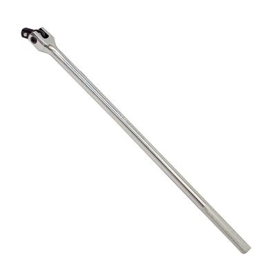

this is a great investment.
usually under 25 bucks...   there are 18 1/2 inch versions and 24 inch versions...  and versions with rubber grips..
the idea is look close at the head...  its on both sides of the handle..  much stronger in my opinion.. but longer when in close quarters...
the trick to getting the really tight crank bolts loose...  except on hondas... is to insert the breaker bar in such a way... its laying on the frame..... up under the frame... laying at an angle against the ground.  use the starter to spin the crank just enough to break the bolt loose....
and before you thing about the nice version with the rubber grip.. it makes it harder to slip a pipe over the handle to really twist off the various bolts that are unforgiving..
ONE THING..... DO NOT EVER USE THIS TO TIGHTEN LUG NUTS WITH...  use a short version .. a cross handle... A TORQUE wrench (click type...)... why....

Wayne, where did you find the fancy one in your picture?
waynep7122 waynep7122
Enthusiast | Posts: 672 | Joined: 08/09
Posted: 04/17/11
07:34 AM
az.....  open the image in a new window... you will see the part number in the URL...
Great Neck 1/2 in. drive socket 24 in. breaker bar with snap Part Number: 38002
Duralast 1/2 in. drive 18 1/2 in. chrome vanadium steel breaker bar Part Number: 72-123
the great neck version is what i have several of..
harbor freight has similar versions..
1/2" Drive 25" Breaker Bar Item #67933
1/2" Drive 18" Breaker Bar Item #67932
there are also ratchet type versions..  and quick release????  i just like the versions with the big round head that fits over the single ring shaped bar end...
the ratchet type may not survive my attempts to remove fasteners..
one thing.. i use them to loosen the bolts and lug nuts.. then use something smaller to finish the job.. the length and weight make them hard to spin like a smaller tool... but .. you will never ever strain your back using one of these...  unless you do so...  picking it up... they are NOT light..
i actually have a 3/4 inch proto version around someplace for the really tight bolts.. like old VW rear axle nuts..   until i found one of these.. i used the 3/4 inch version daily.. with a 3/4 to half reducer...
if you are tearing down motors...  or doing a late model head job...   you will really need this...  i have found the head bolts in so tight that it took 2 of us pulling on the 24 inch version to get them loose..
when putting the last 1/2 turn on TTY head bolts...  you can get a easy quarter turn on the head bolt.. then rotate the socket a quarter turn on the breaker bar...  then pull another quarter turn...  makes life easy...
