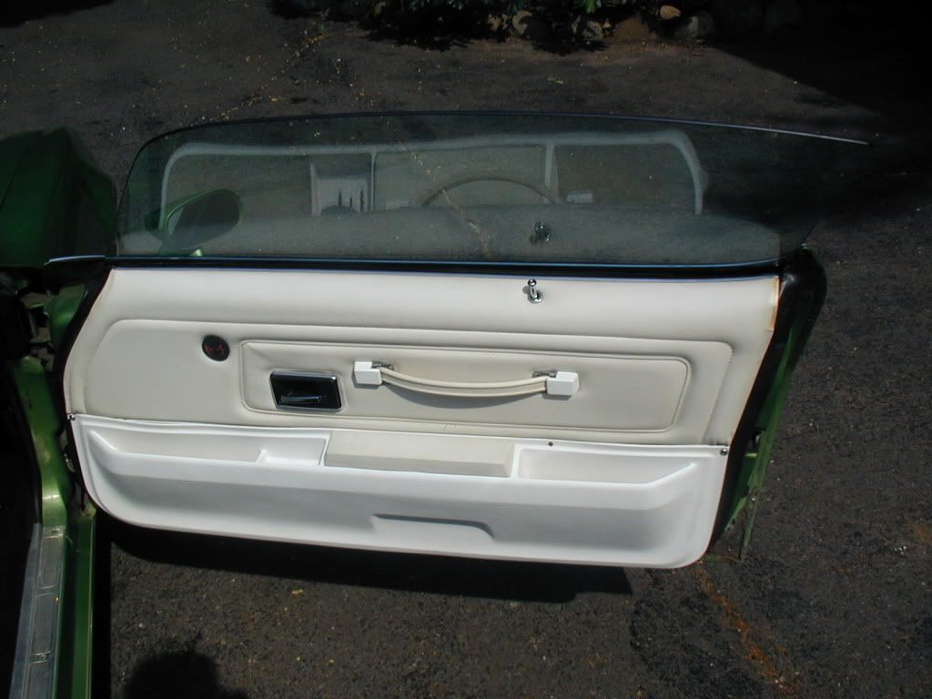

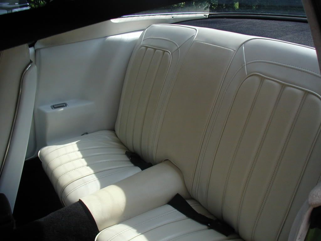

I have used Duplicolor white and SEM top coats.  Sem offers every factory color under the sun, while duplicolor has the basics.  The duplicolor white is a little bright for my factory interior, but it came out very well.  The SEM paint can only be purchased online or from a auto paint and supply shop and is almost 3 times as much as Duplicolors.  Both have good adhesion properties.  Its all about prepping and cleaning the plastic.  I used SEM plastic prep in the liter can and it works great at removing grease, grime, and 30 year old Armor all. I redyded a set of camel tan seat backs, the rear arm rest panels and the lower door panels and it came out quite good.  If you have any chaulking, sand it of first with some light grade sand paper or you will have adhesion problems.  I have used adhesion promotor in certain applications.  Most of the time, the promotor in the top coat it self is sufficient.  Cool
Here are some pics of my interior freshly done.
P1010298
P1010086
P1010309
P1010305
P1010297
