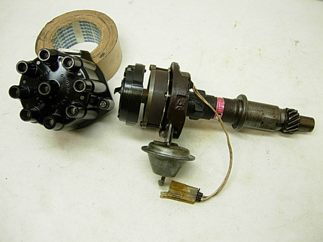

i have a pontiac transistor ignition distributer kicking around here someplace... and the ignition box to go with it.. somebody had dug into my box of distributers a while back.. needed a poncho drive gear... grabbed the drive gear off it... the only gear i told them they could NOT have..
this is what it looks like if it were complete..
