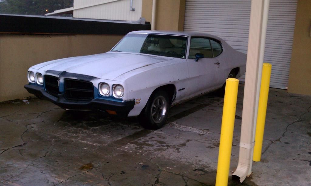

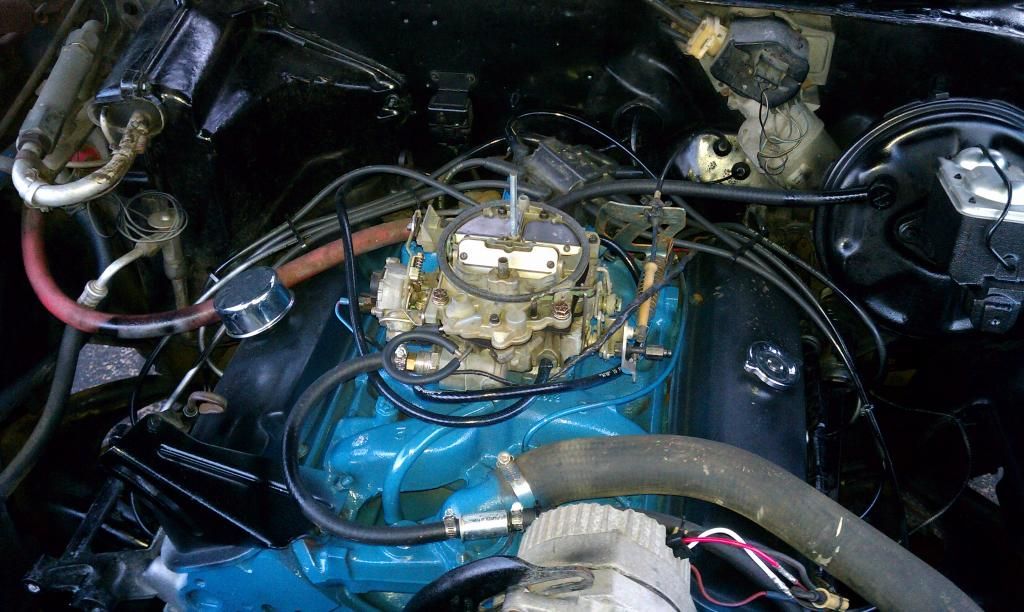

Hello everyone, I have a 1972 lemans that i am building and would like to pick brains on some advice for the build. The car was pretty straight when I got her, no major problems beside some rust in the usual places. The current set up consists of an a/c 400, 7J2 heads, stock intake, quadrajet, Hei distributer, TH400, 2.73 rear, and discs up front .
All my buddies are telling me to yank out the poncho and drop in a 383  stroker but I refuse!  To shut them up I'm leaning towards a 462 stroker for this project if possible.
1. I Know the 7J2 heads have to go. They are low compression, small valve, and are missing the end holes, so no real header options. I have a set of #17 heads I was thinking of using for the build after some modifications. I was thinking of having the bowls enlarged, installing 2.11 intake/ 1.77 exhaust, port & polish, screw in studs, new springs, rollers, and mill a bit off for flatness. Brand new heads are not in the budget. Your thoughts...
2. I have an Offenhauser 360  Intake I found in a scrap yard, don't know anything about its flow pattern, anybody have any info on this one? From what I gather the stock intake flows pretty well and can be polished as well. Maybe a 1" spacer to increase runner length and thermal isolate carb.
3. Can I and should I keep the quadrajet? I hear it's not bad, but will it be enough to feed my 462 or does it need modification.
4. Cam selection. This will mainly be a street car, however I wan't as nasty an idle as I can possibly get away with and still have use of the power brakes with an additional vacuum canister.
5. Transmission. Bone stock at the moment, Shift kit? Remove valve spring?
6. Rear end. As i said this will be a daily driver so I'm not too sure about ratios. Posi is great for drag racing not so much for every day driving. Your thoughts....
I know this is a HUGE post but I thought it might   get interesting.
