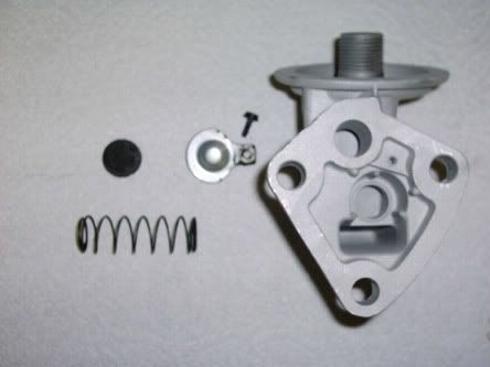

Here's what a stock oil filter adpater looks like, and the bypass parts.
Stockbypassandparts1
The small metal cover and screw holds the spring compressed against the fiber washer.

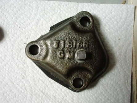

Here is a picture of the factory "bypass" I use.
Gmpiece518168
Less hassle. Less weight. Clean oil. No problem.
