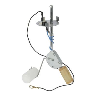

couple weeks ago i stopped to get gas, it was almost full an 3 days later the gauge was still on the same line, im driving a 66 bonneville not a prius lol so i thought the float stuck, so i ordered a new sending unit and i put it in yesterday, i put in a new gas gauge to, i turned the car on and the gauge still wasnt reading anything? i made sure the wire for sending unit was hooked up, it was grounded, the gauge was wired right, i ran a wire from the battery to the back of the gauge just to make sure the gauge worked an it did, so i dont know what could have gone wrong from putting gas in my tank to now it still not working with new parts?! any ideas? help.

put a new fuel sending unit in, grounded it, i bought a new gauge, made new connections, grounded the gauge, i ran a new sending wire from the sending unit to the back of the gauge, turned the key an still nothing,
i unplugged the sending wire from the sending unit, took a test light grounded it an stuck it in to the sending wire connector an the gauge went full, all my other gauges an gauge lights work, its a new sending unit, cant figure it out an its starting to be a pain in the butt dropping the tank everytime to get to the wire lol

with sending unit UNPLUGGED .. the gauge should go one direction..
ground the wire thats unplugged from the sending unit and the gauge should go the other direction...
this tests the gauge and the wiring.. not the sender..
testing the sender...  set digital meter to 200 OHM scale or 2K ohm scale..
   SW - SW gauges - 240-33 Ohms
   VDO - VDO gauges - 10-180 Ohms
   GME - GM up to 1964 - 0-30 Ohms
   GML - GM 1965 and up - 0-90 Ohms
   ORG - Early Ford & Mopar - 73-10 Ohms
The first number of the (Ohms) represents empty and the following is for full.
if you have installed a sending unit for the stewart warner gauge.. it won't work the factory pontiac gauge very well at all..
you will need to not just test from the connector terminal on the sending unit to the flange on the sending unit. but also to the tank.. and also to the body...
there is almost always some kind of ground connection on the tank.
so... at the tank.. since you tested it with a test light.. the gauge and wiring are probably OK.. its the sending unit.. or the connection between the sending unit and the tank.. or between the tank and the body...

i will try that, i couldnt find the right sending unit that fit for my car,they gave me a sending unit for a 67 impala.. diffrent car but fit better the one for my 66 bonneville,  that one says the ohms are 0-90,  i have 2 gauges one is sunpro an the other is dorman, both say ohms are 240/33, is that my problem? i need a gauge for 0-90 ohms?

Spectra Premium/Fuel Tank Sending Unit
Part Number: FG88B
Notes: Fuel sender, strainer and float (Pump not included); 3/8" outlet
Part Number: FG88A
Notes: Fuel sender, strainer and float (Pump not included); 5/16" outlet
many stores sell spectra premium... AZ is one and tanks to pans is another.

i bought a gauge yesterday that is 0-90 ohms the same as what the sending unit is

here's the correct sending unit. they also sell the gauge.
http://www.opgi.com/bonneville/GBC2304/
