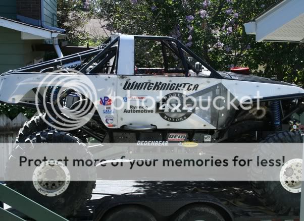

My bud Robin's rig with Accel 950 EFI
Robinsrig 1
