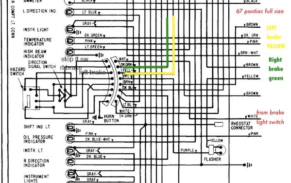

Looking for a little technical advice on my 67 Pontiac Grand Prix.
No tilt column and we do have cornering lights.
I replaced the turn signal switch with a RED Boyne switch  (purchased from Lectric Limited, Inc.).
Now I have no brake lights. (Brake lights worked prior to replacing switch)
Bulbs are good
Good ground
Brake light switch is good
When I put power to the brake light wire the light lights up
Good Continuity
Running lights work
Turn signals work
…..still NO brake lights.

try this..
probe the white wire into the turn signal connector.. thats from the brake light switch.. push the brake pedal.. and that should have power then..
if the turn signal switch is centered.. you will find power when the brake pedal on the wires going to the left and right brake light..    yellow and dark green.
67Pontiacfullsizeturnsignalconnector Zpsb2fb214a

When I put power to the brake light wire the light lights up ? Were are you putting the power at ? At the brake light switch ?  Or in the trunk ? The brake light wire is white going to the turn signal switch then it uses the turn signal wiring , yellow left , green right .  Wires002 Zpsc90bb684

did they say what the difference was beween the tilt and nontilt switch? i would think it would just have longer wires. if they were different there should be more than one wiring diagram.
i wonder if the white wire is in a different location on the conector or not fully engaged!
