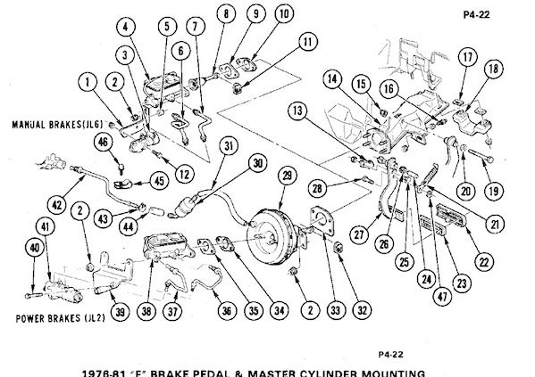

you probably need to CLEAN and RELUBE the brake pedal pivot and its bushing at the top of the brake pedal.. its probably gotten some condensation and caused some rust buildup..
bushings are item 11 on this first image..
78 81Fbodybrakepedaldiagram Zps0ad74431
and the bushings are item 26 on this image below..
78 81Fbodybrakeboostermasterandpedals Zps68d31084
the master cylinder and brake booster return springs are the only thing that pushes the pedal back up against the upper stop..
you can get dorman part number 74016 brake pedal bushings and those will more than likely fit.. there are 3 different pairs of bushings in the package...
the 74017 should be an exact fit for your brake pedal bushings with just 2 in a package.. but most stores will have the 74016 as one part number covers more applications..
AND.. yes.. you can change the brake pedal bushings without taking the dash out of the car..  you might want to take the driver seat out for additional room and throw a piece of plywood down and some cushions off the patio furniture.. or even a folded movers blanket from Uhaul , self storage or harbor freight..
