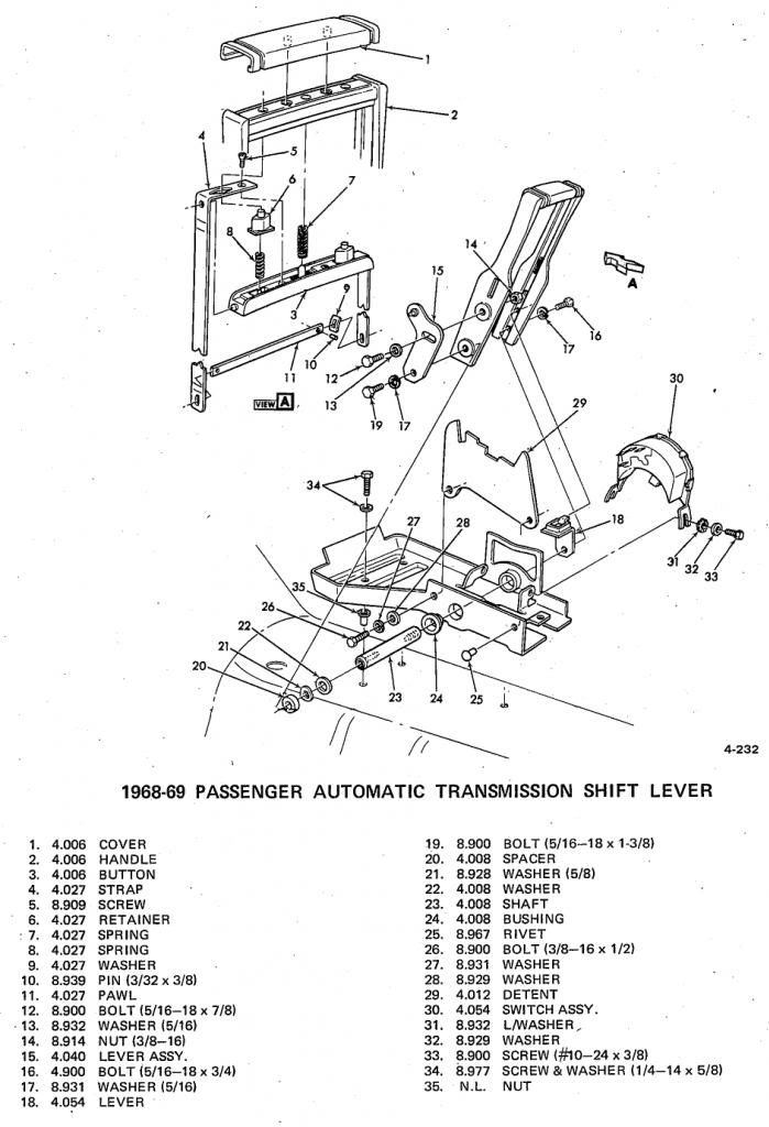

got pictures of your shifter.. straight down.. so we can see the size..  we all don't have 69 GPs... i don't recall off the top of my head.. what the shift console looks like...
i have seen bushing kits to repair GM console shifters.. where the plastic bushings have worn out..    i have a long time ago..  needed to quickly repair the shifter bushings. i was very bad.. had nothing in the shop.. so i cut the plastic top off a spray can into strips..  and wedged that in around the pivot bolt.. worked great..  i also cut thrust washers out of it for the sides of the shifter where the bolt passes thru..
and.. i have seen flange bushings of various sizes in some either ace or truevalue hardware stores.. in the drawers of fasteners.. not all stores have that drawer..
if the bushings in the cross shaft are worn.. allowing the shifter to rock around..
measure the shaft and the opening..  perhaps.. some parts might be available.. perhaps from a corvette supplier.. as the had automatic console shift cars also.. will they fit???  whats broken..
and could the issue be inside the transmission.. it is possible for the nut that retains the detent plate inside the transmission to come loose..  just before it completely falls off..
68 69 Chevyshifter Zps4151feb6
i know this is the wrong shifter.. but its the only one that shows the bushings

On fixing up what you have ... I think if your car has as few miles as stated, the shifter itself isn't going to be the trouble. Old cable, missing, damaged, or misadjusted linkage parts or brackets, or dirt in the shifter are more likely culprits. Like Wayne said, some True Value stores do have a suprising array of bushings and what-not, but you'll need to look into the shifter first. The bushings in that diagram are shaped a lot like pedal bushings, hmmm. Fabrication to the rescue!
