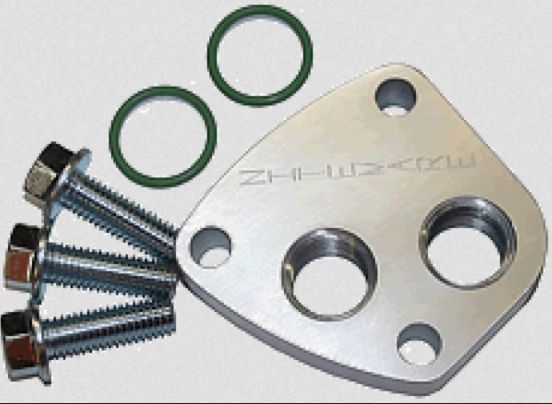

this has been a thought bouncing around my head for a while...
do you have the ability to make a block off plate for the oil filter adaptor???
so you can remove it and bolt on this plate..  with a gauge on the oil pump output passage.. without the bypass in the adaptor so you have blocked off all the engine oil galleys... you are working with just the oil pump and a few inches of passage..
found one
Pontiacoilremotefilterada Zpsa7975467
Pontiacoilfilteradaptor Zps9a204769
how hard would this be to make out of something a little thicker so you could use a stock gasket to seal it to the block and not leak for the 3 minutes of drill testing.. as you would not crank the engine..
hint.. if you had a shut off valve and a hose that looped back to the other passage..you could dead head the pump for bypass valve pop off testing and max pressure. but then you could open the valve and see if the oil system has tight enough bearing clearances to restrict the oil to build pressure.. again with the drill..
and if you are worried about sending unfiltered oil directly to the mains.. study how the oil filter relief valve works in the oil filter adaptor..  Shocked
end edit.

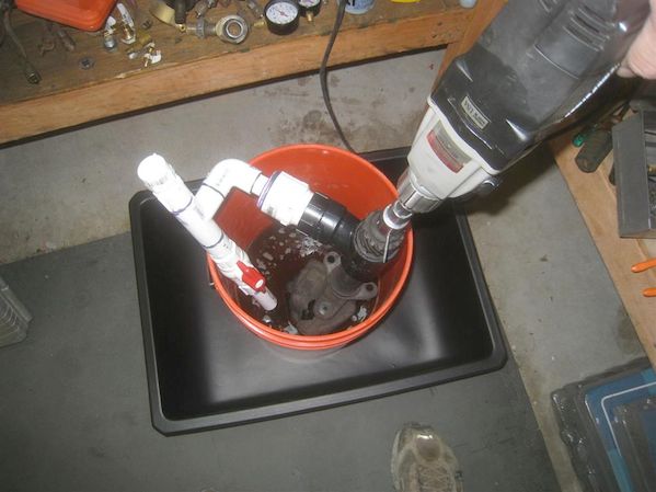

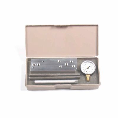

spin the oil pump up using an power drill... see how much oil pressure the pump can create .................................  see where the pressure bypass opens...
this can be done in the motor... without dropping the pan...
the block off plate could be created in half an hour ...
this is how the bypass pressure is tested...
Oilpressurereliefvalvetester Zps869183af
Oilpumppumping Zpsd2a4094e
Oilpumpbuckettest Zpsd47e9cf9
Oilpumpdyno Zpsfb3d7a1f
harbor freight has a torque device... allows you to use a breaker bar as a digital torque wrench..  i wonder if you could rig your oil pump drive tools to allow this to be in the middle and if this has a min max type setting.. so you could spin the drill till you got the oil pump bypass to pop off .. and see how much torque it took to do so...
Image 10461
the problem i see without blocking off the oil pressure adaptor... is you cannot block off the flow to build max pressure inside the pump..  so if the bearing clearances are opened way up because of the lack of pressure.. the flow will be tremendous.. and you cannot build pressure..
sorry i cannot seem to get out what i mean...
i know that here in los angeles there is an oil pump rebuilder.. they have an oil pump dyno.. they actually test oil pumps for engine rebuilders.. when there is an engine warrantee issue..

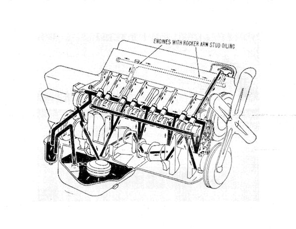

they can chart oil flow by RPMs
they can chart torque required..
they can chart pop off pressure..
next time i am down in that area of los angeles.. i will stop in and ask them if i can snap a few images or perhap take a video of the oil pump dyno run..
in the mean time.. i really worry about you driving your car...  ZERO pressure is not enough to float the crank and cam on the bearing surfaces... you are going to get to the point where the bearing surfaces melt and weld to the crank journal and spin in their housing or big end bore.. at that point you are going to be in deep trouble..
an Oil pump that came loose on the block can also create this issue.. as can a pump that blew out the mounting gasket..
lets see.. if you install the plate above.. you are only testing the oil pump as i describe..  exactly...

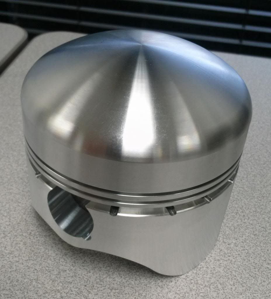

and if that does not work.. just stuff in some high compression pistons..
Bigdommedpiston Zps574db02d
sorry.. i could not resist..  Laugh
hmm... just had a thought.. i could pick up some of these pistons.. a few bottles of diet soda and some mentos.. visit the battleship iowa .. see if i could get into one of the big guns and have some fun..  wwwooooosssssshhhhhh...

"with a speed handle.. or a medium large variable speed drill.. spin the pump and see how much pressure you can make..."
I figure I pretty much already did this with the engine spinning the pump, and it was insufficient press.
I love the idea of making a tool to test the oil pump.  This is something that would often come in handy.  The first image will not load on my screen for some reason.  It just shows a little icon in its place indicating an image was supposed to load there.  But, I can picture what you're describing.  You could use it to test the oil pump output, and then the pressure loss once allowed to pump through the galleys.  On an engine with some mileage, you could tell whether an OP issue was due to a worn out pump or to some pressure loss in the system from excessive bearing clearances or what have you.  Maybe an adapter could be rigged to serve this purpose as a diagnostic tool?

"I figure I pretty much already did this with the engine spinning the pump, and it was insufficient press."
how do you know it was insufficient pressure when oil gushes out the adapter and your engine can sit for more than 3 seconds without the lifters making any noise and the crank doesn't seize and there is 0 metal in your oil?
we already know your gauge is inaccurate because no oil comes out the line when it is disconnected sat the gauge with the engine running.
