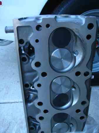

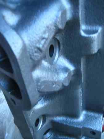

Anyone ever heard of the early #12 head castings having the #2 (in 12) stamped instead of cast? I really want to buy some nice #12's off a local guy that seems trustworthy but this is news to me. Seems like someone may have ground off the whatever # was there and stamped in a 2. Any advice would be great! Thanks all....

What's the date code on the heads ?
Code400 Code400
New User | Posts: 34 | Joined: 02/13
Posted: 04/25/14
02:35 PM
November '69

The only heads I could find in 69 that starts with a 1 is #16 heads . #12 heads are 70 heads both are good heads if they are large valve heads .

In the first place never say never in the Pontiac world, they did things at times for apparently no good reason. On the other hand one should remain cautious here as some heads flow better than others, obviously they are not oval port heads.
If the date code is November of 69 this would indicate a head cast for the 1970 model year. In that case there are several candidates, although if the combustion chamber has not been altered you could cc them to narrow your search.
My advice is try to research other markings to help identify them further.
1970 Heads
350 255HP        #11    1.96/1.66 8.8 c.r.
400 265HP        #11    1.96/1.66 8.6 c.r.
400 290HP        #16    (sm valve) 1.96/1.66 10 c.r.
400 330HP        #16    Big Car 1.96/1.66 10 c.r.
400 330HP        #12    (m.t.) 2.11/1.77 72cc
400 330HP        #13    (a.t.) 2.11/1.77 72cc
400 345HP        #12    (FB/RAIII) 2.11/1.77 72cc
400 350HP        #13    (GP) 2.11/1.77 72cc
400 350HP        #12    (GTO)(MT) 2.11/1.77 72cc
400 350HP        #13    (GTO)(AT) 2.11/1.77 72cc
400 366HP        #12    (GTO)(RA III) 2.11/1.77 72cc
400 370HP        #614  (RA IV)(rd port) 2.11/1.77 71cc
455 360HP        #15    Big Car 1.96/1.66 87cc
455 360/370HP #64    (GTO/GP) 2.11/1.77 87cc
Good luck and please let us know what you find out.

Cool thanks, yeah I'm going to pass on them. The asking price is too high for the unsure casting # plus the machine work done, intake valves were replaced but the exhaust side looks untouched. Thanks for the info! I guess I'm just becoming impatient to get my short block together and might just fork out some extra $$ for Edy's...

Well I bought these heads and they are on there way to Vermont. i see there was some discussion as to whether these heads are legit or not. I looked very closely at the enlarged view on the ebay ad and there is something interesting about the stamped number. When you look at it extremely close you can see that the grain of the casting hasn't been disturbed. If the number had been ground off, the metal would look different. it would be smooth and shiny,it's not. Look close and the grain of the cast iron looks identical to the left side only with a "2" stamped in it.You never know the cast 2 might not have showed up they day they were cast, could have been an oversight when they were made and not caught until after they were cast.also these are consecutive heads with the same casting date and they both look the same as far as the grain. I also agree with the other gentleman on here about never saying never, I have seen some weird stuff over the years as well. I also had a long conversation with Tom, (the guy that sold them to me) and he has included all the paperwork from the machine shop and the intake valves were replaced but the exhaust valves were in great shape. So if someone went through these and they were not originally 2.11/1.77's then someone went to an awful lot of trouble to make them this way when they could have just bought 72cc chambered heads elsewhere.I had no problem buying them, have you seen lately what it cost to have all the machine work on a set of heads. The machine shop here in VT wanted 1800.00 to do my # 62's and that was not including porting, polishing or trick head work.So what it all boils down to, is I couldn't have had a set done to this extent for the price I paid for them and at the end of the day they're 2.11/1.77 72CC chambered heads that will run very nice on my 67 400 for my goat.

2.11 1.77 72cc screw in stud ,open chamber,D port heads are all the same ram air 3 or standard . As long as your not looking for the heads that came on your car it makes no difference .I would cc the heads to see if they are 72 cc heads .

Yes I'm sure they're legit, I spoke with Tom as well. I called Butler performance and was lucky enough to get Jim Butler on the phone. He said he has seen castings that came out strange before, but he didn't like the fact the machine shop only did the intake valves, he had a long explanation in great detail, which was the main reason I passed. Anyway, I'm sure they'll be fine and since I had a pair of #16's completely redone with some mild bowl work, and the springs/retainers that match my cam installed for $875.
